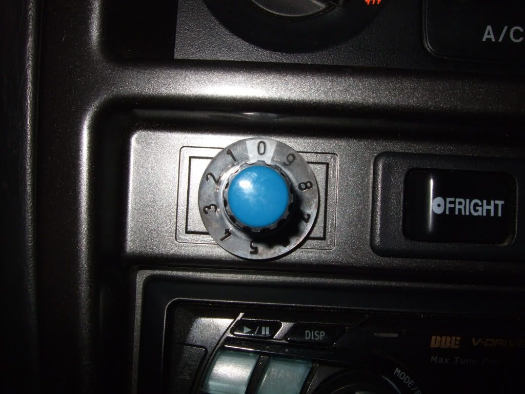

New switches. Map 1 = V Power / Map 2 = 20% Methanol. / On Off switch = Anti Lag
The Loud Dial
With the car at a stand still, turn switch to "1", Put throttle to floor, (3500 rpm). wait about 5 seconds for WW3 to start then dump the clutch and you are somewhere else very quickly
Through to "9" which is set at 7500 rpm.
These settings are designed to suit different grip levelS that are generated from the under type surface.
