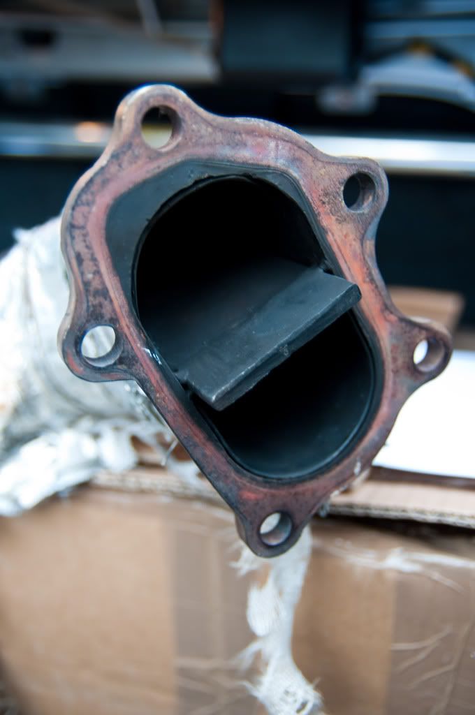

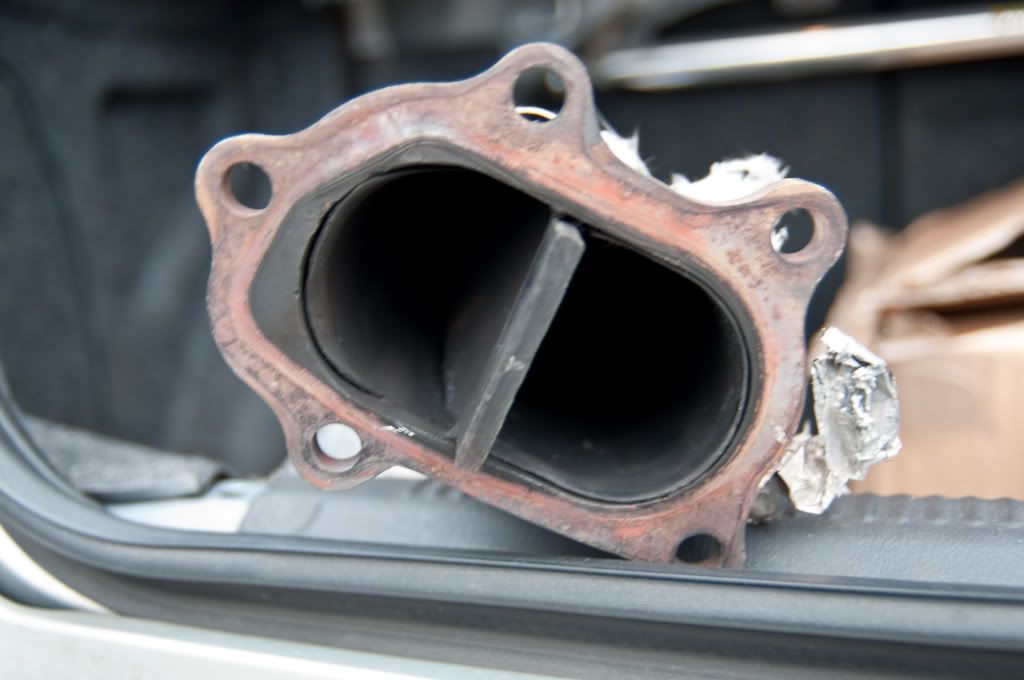

I am getting the de-cat sytem fitted tomorrow.
The downpipe I have got, has got a metal spacer inserted into it (please see the pictures below) and wanted to know what, why and where fors?
Speaking with Martyn on Saturday, he mentioned he thought that this was a bit of a fad mod a few years back, as a way of keeping the gases from the dump valve seperate from the exhaust gases.
It is only two small tack welds on it so easily removed if I wanted to.
Any information / opinions would be greatly appreciated.

not seen that before i would take it off it must restrict flow

i would say its to do with the separating the wastgate gasses to the exhaust gases to speed up gasses overall, how far does it go down?
Old 19-10-2009, 12:57 PM
ive seen that on a few down pipes on driftworks, not entirely sure how it works but i think it seperates the gasses to the waste gate, but on drift works they have a seperate pipe welded to the down pipe for it
Old 19-10-2009, 01:00 PM
It is for the seperating of gases, there are a few write ups on scoobynet etc. Think it was never proven if it made any benifit.
I woulkd get a pair of grips and remove it, any lumps/weld tags left inside need to be ground back.
YHPM
Old 19-10-2009, 01:17 PM
MrX???
Its a divorced wastegate style downpipe.
The theory is that by seperating the exhaust / wastegate gases, you smooth out the flow of gasses from the turbo.
Thought to bring back the loss of low end torque that is a result of going from 2.5 to 3' system,
I would leave it in and see how it goes,
Old 19-10-2009, 01:21 PM
Tone, on further inspection, it actually goes down about 9 inches and narrows. I would say that this is a definate for keeping gases seperate.
It also looks like a good job has been done with this, it's not just a simple tack weld but a well made bit of kit. Interesting.
Old 19-10-2009, 01:22 PM
it was a fad mod as Martyn mentioned.
You need to be careful it doesn't fowl the wastegate on your turbo.
TBH I would knock it out.

Just found some info.
http://www.scoobytuner.com/tuning/?tuningID=15
Old 19-10-2009, 02:14 PM
Good info matey.
I would say its up to you really, cant see it sgoing to make much diference either way. just need to make sure the devider does not foul/interfere with the turbo fitting.

another vote for take it
