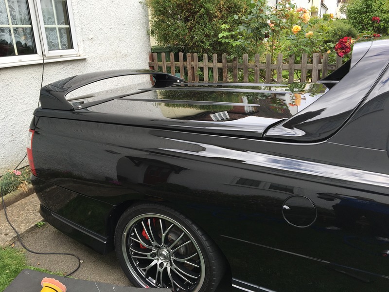

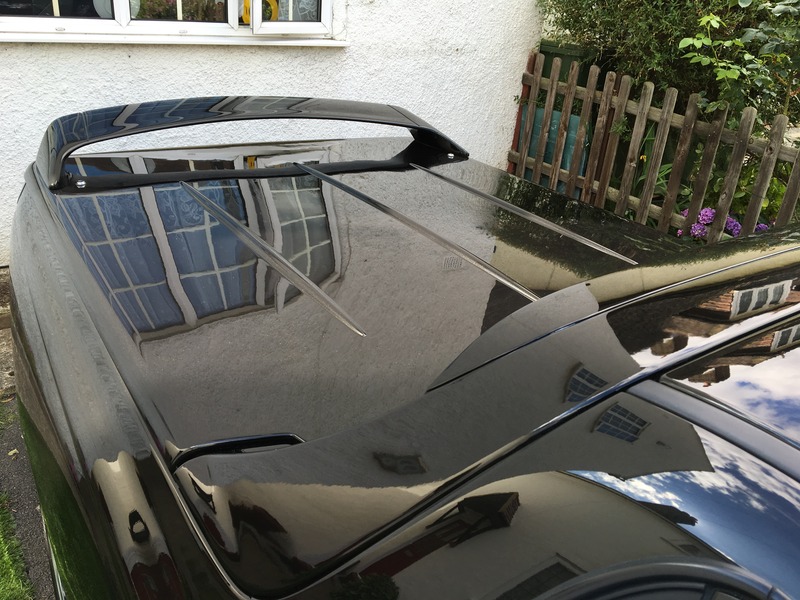

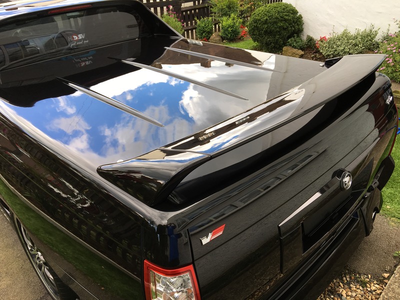

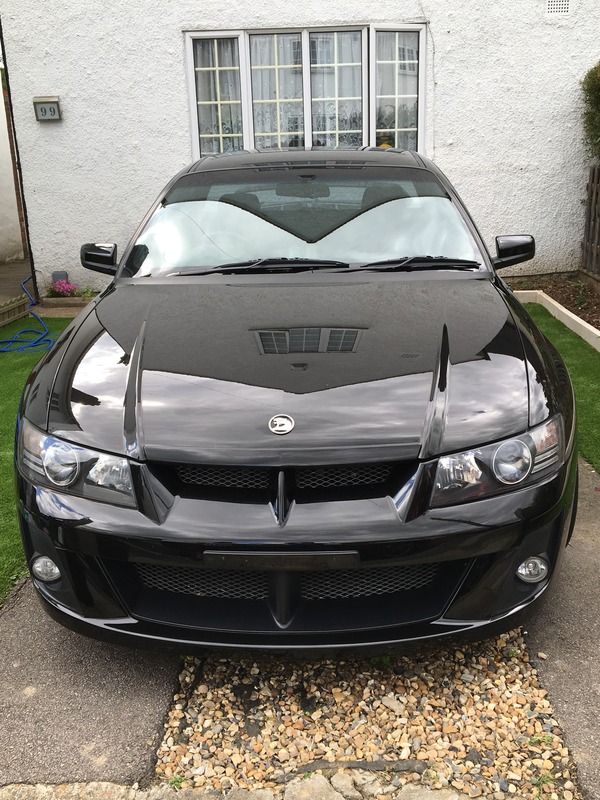

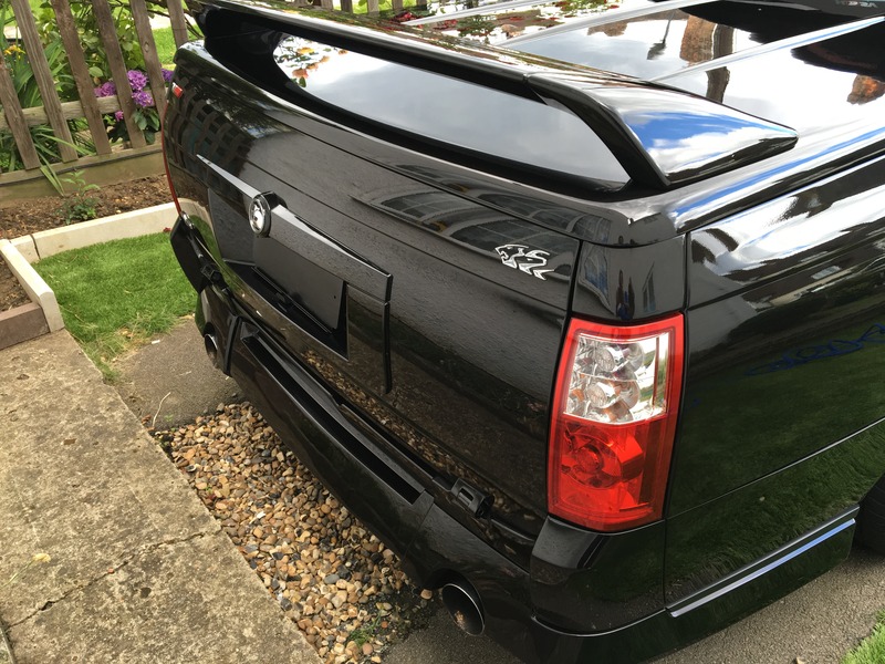

Well spent a day with Ian in the sunshine working on his beast of a ute!
It's bloody enormous!! 7hrs later but I think Ian was pleased and I thought it looked good.

A BIG thanks to Ryan for his hard work today, i'm more than pleased with the results and can't thank you enough, i keep looking out the window at it now

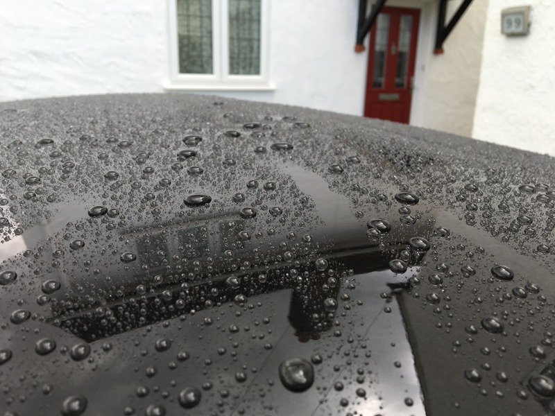

Oh and for those interested -
Rinsed
Valet pro ph neutral snow foamed
Rinsed
Wheels cleaned using valet pro bilberry wheel cleaner
Rinsed
Clay mitt + chemical guys synthetic Detailer
Patted dry
Menzerna compound polished
Menzerna power lock sealant
R222 wax (granby's)
Gyeon wetcoat
Patted dry

only advise I would offer is going from the list above, watch your layering
The power lock needs time before even a second coat of the same and the R222 would be better left for 24hrs before anything put on the top
The Gyeon wetcoat is a great product but remove that from your list and use a glaze coat prior to the power lock for a wetter deeper more protected finish
use the wax as a sacrificial layer, the power lock is the protection

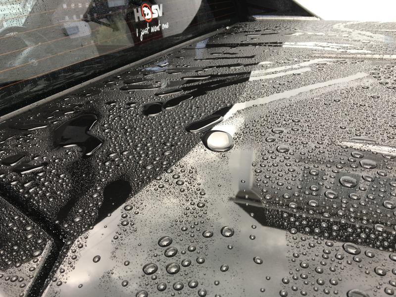

again not trying to pick holes, just offering some advice if you choose to take up on it....... Get out of the habbit of spraying water on top of a just finished sealed or waxed surface doesn't do the products any good and can in most cases reduce the quality of finishes it can also have a negative protection effect on the products...
Best time for a beeding shot is straight after you have cut the paint back, when its at its most natural take a pic at IPA stage on a black surface and you'll get as good effect without any negative effects...
again, not looking to come across as critical they really do look fantastic jobs you've done recently.......
