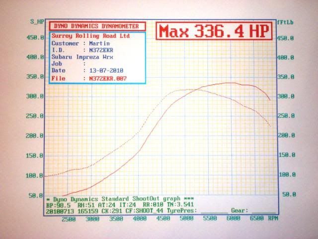

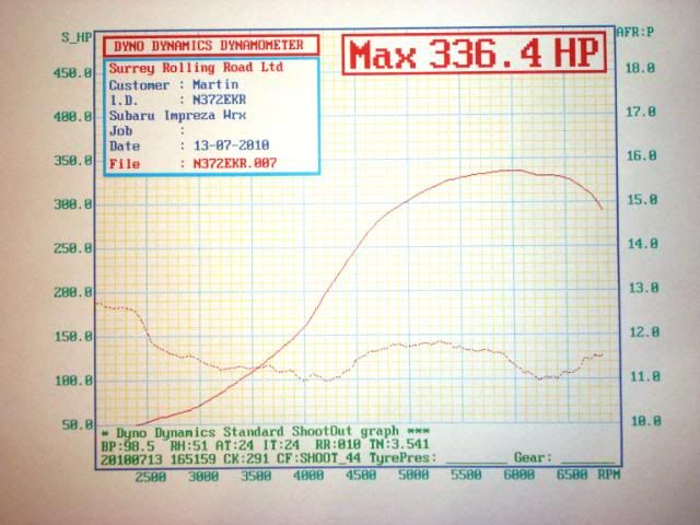

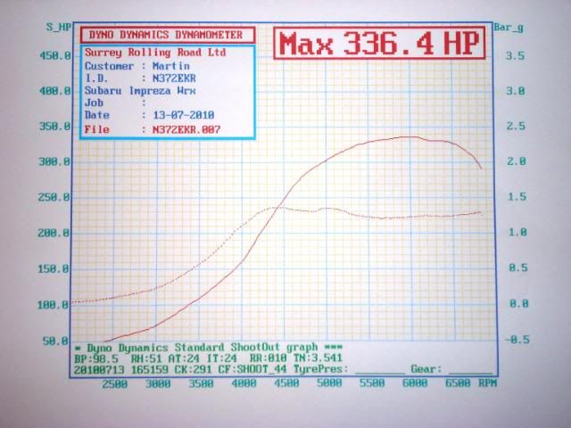

Took a trip up to SRR today to get the scoob tweaked on the rollers,as Simon (JGM) had road mapped it and advised it would be benificial to get it on the rollers.
Met some nice guys and some nice cars today also, hoping to see a couple on here.
I am very happy considering my very minor mods consisting of:
Apexi Power FC
AVCR boost controller
FMIC
440 injectors
Standard TD05 16G
Stainless headers
Full Decat
Made 336.4BHP and 322ftlb torque
A few pics below, The Type R made 390bhp and 385ftlb torque and was mint.

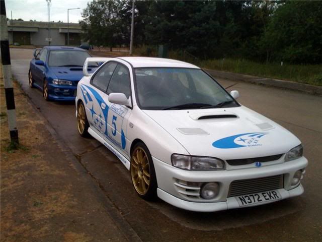

The silver classic made over 450bhp if i remember right
The wagon never made it on the rollers due to being overfilled with oil,causing oil to blow throughthe IC and out the dump valve, the car itself was really nice.

Nice graphs Martyn! Thats a clean wagon there as well.

Good figures for 440's mate (0.6BHP more than me ), they must be pretty much max'd by now.
I thought you were running 550's
390BHP one looks like it's being pegged back for something or hitting a mechanical limit somewhere, as peak power is very early and torque takes a dive.

yep 440's and Maf maxed out. Am sticking with it as it is now as will be tucked back in garage once I get the new scoob.

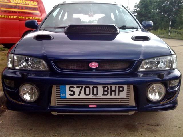

the wagon was mint, it has coil overs and big aprodrive brakes plus engine mods, full leather interior. Wheels are pants IMO

and dont forget about the STi8 bonnet scoop.... Minging
And it's a proper carbon one, but not my cup of tea, wasn't going to tell the owner as he is a judo instructor
Old 14-07-2010, 10:25 AM
and with a front mount he dosnt need the extra flow for a topmount.... I'lll be losing mine soon

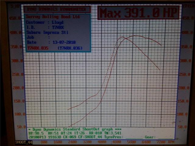

Nice results Crowman! How does the car feel in comparison now?
Nothing major, but fuelling and boost seem a tad inconsistent though?
What happened with T7 WRX, that curve drops like a stone!

The car feels great again,as it was crap after i fitted the headers and FMIC.
No plans for any further mods as is only a second car,will be concentrating money on new one
T7 WRX made 370bhp on V power and 391BHP with octane boost added
Not sure about the curves, have to hand that one over to JGM to answer.

Some of the changes in the fueling plot is swirl in the exhaust. Ie. It is not the true fueling in the cylinder.
Dont get me started on t7wrx, there is possibly an issue somewhere (cambelt wrong, intercooler leak etc). But turbo runs out of puff at the top so also could just be turbo maxxed.

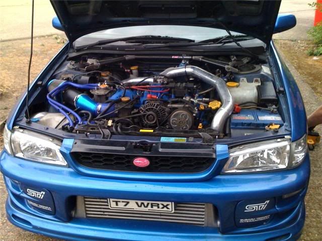

That blue Type R looks a little bit sexy as well - is that someone from here?
