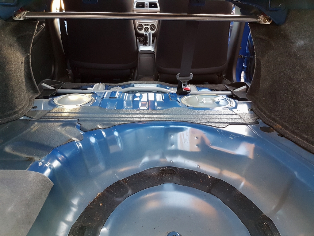

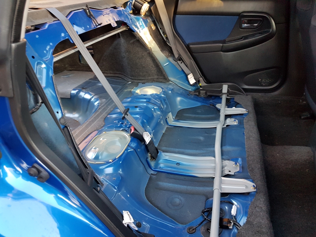

Rob and I were bored this afternoon and looking for something to tinker with.... so operation track scoob has commenced
Also removed front speakers and head unit as it never gets used and they're old and naff. Whilst the door cards were off, I discovered (and remembered) that when I got the car I fully dynamatted the outer skin of the front doors about 10 years ago. Probably made sense at the time, yet its unnecessary weight now
It's certainly not coming off though, sticky as hell that is

If you warm the dynamat with a hairdryer you can get about 20% of it off and cover yourself with the stickiest black goo known to man!
Yep. Don't think i'll be bothering with that, horrible job!

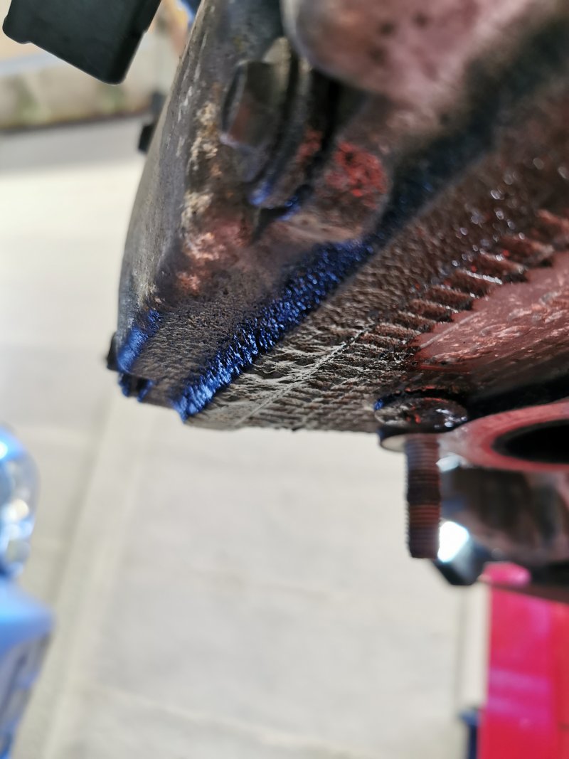

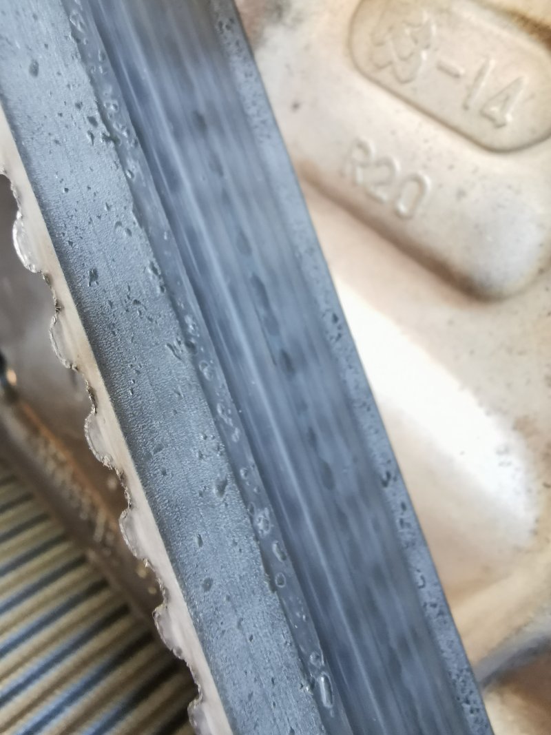

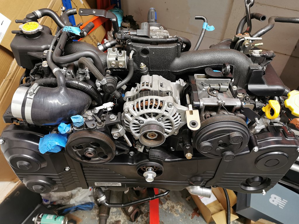

So, the replacement engine....
Shiny bits...

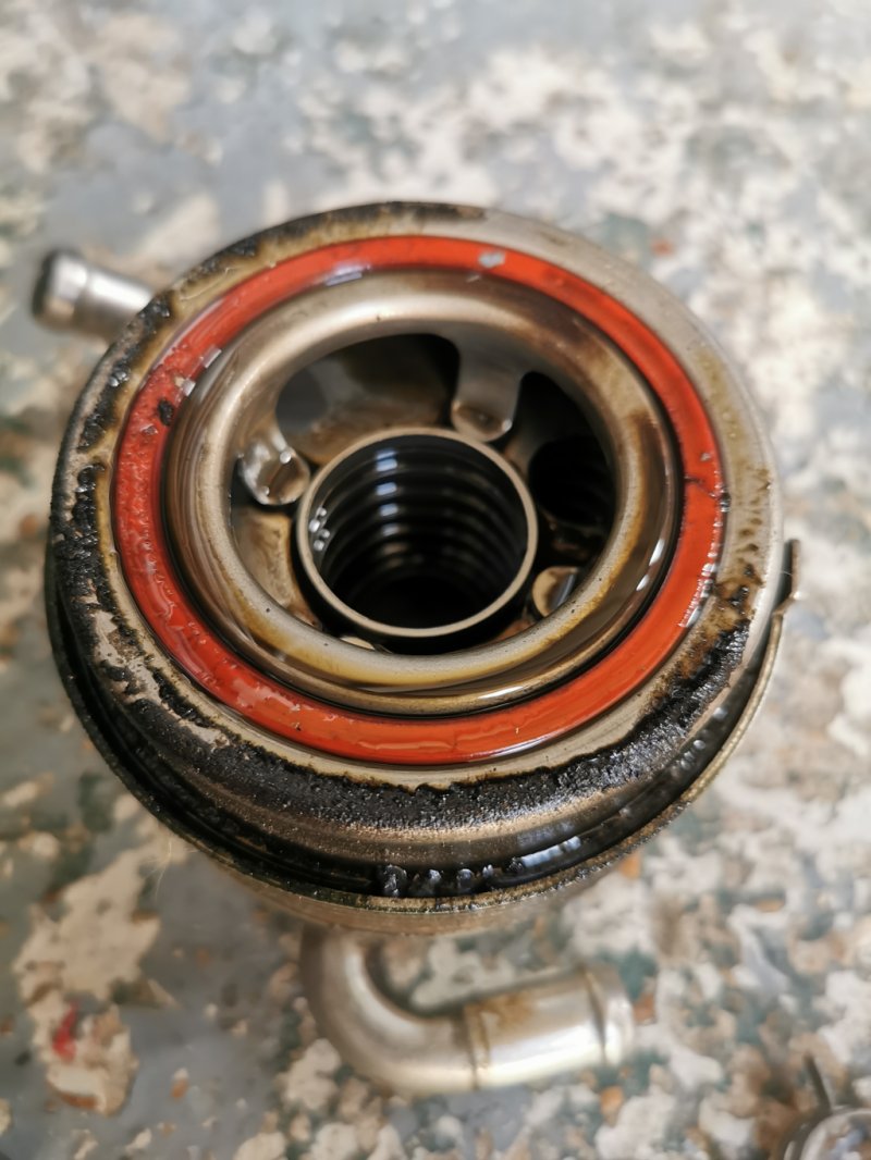

I checked a few things over and decided to replace the modine seal as that's failed on my scoob before. For £7 its a lot easier to do it now and clean everything up.
Old seal doesn't look great.
Cleaned, seal replaced and back together.

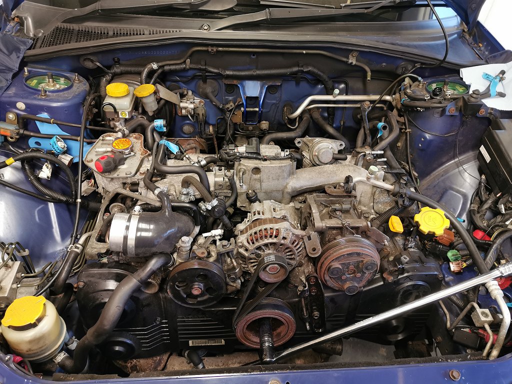

So, onto the removal of my old engine. I've done a fair bit of reading online and it seems there's nothing you can't learn on Youtube these days. I found a channel by some US guy who goes through every single step to pull a newage engine, which helped with advice and the best order to do things in.
https://www.youtube.com/c/SubaruONLY/videos
I know some of you can do this with your eyes closed but watching the process on youtube gave me the confidence that I wasn't going to screw up!
Anyway, this is where we started...
Battery, washer fluid bottle, air box etc removed, coolant dropped and radiator out. Then onto the crankshaft pulley bolt - which was seriously tight! I'd read online that it was easier to remove whilst the engine was still bolted down, and to use the old aux belt wrapped around the alternator to stop the crankshaft from spinning. Worked in the end
You can see the general condition of the old engine. Surface rust, grime. Not terrible, and it worked fine - but just looked a bit tatty.

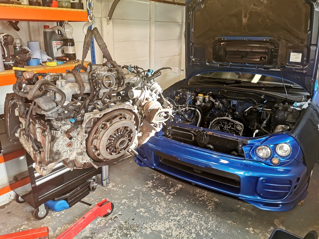

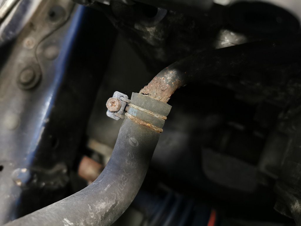

Next job... removing the alternator (which I wouldn't need), the air con compressor and power steering pump.
Both the a/c compressor and PS pump I left connected to hoses, but moved aside to allow the engine clearance to bit lifted. You can see the PS pump held in place with a bungy as it didn't want to stay there on its own!
Finding things like this.... not confidence inspiring when I think about the possible implications of dropping fluids on the Nurburgring. This is the hose at the back of engine (normally hidden under intercooler) that connects the heater matrix.
Out she comes

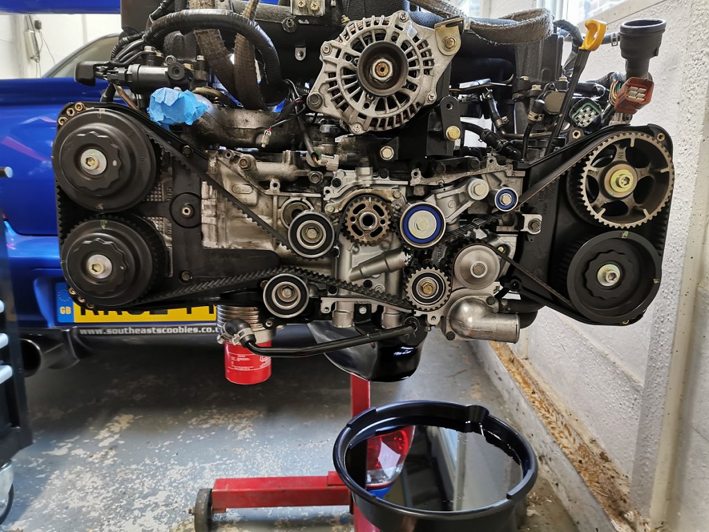

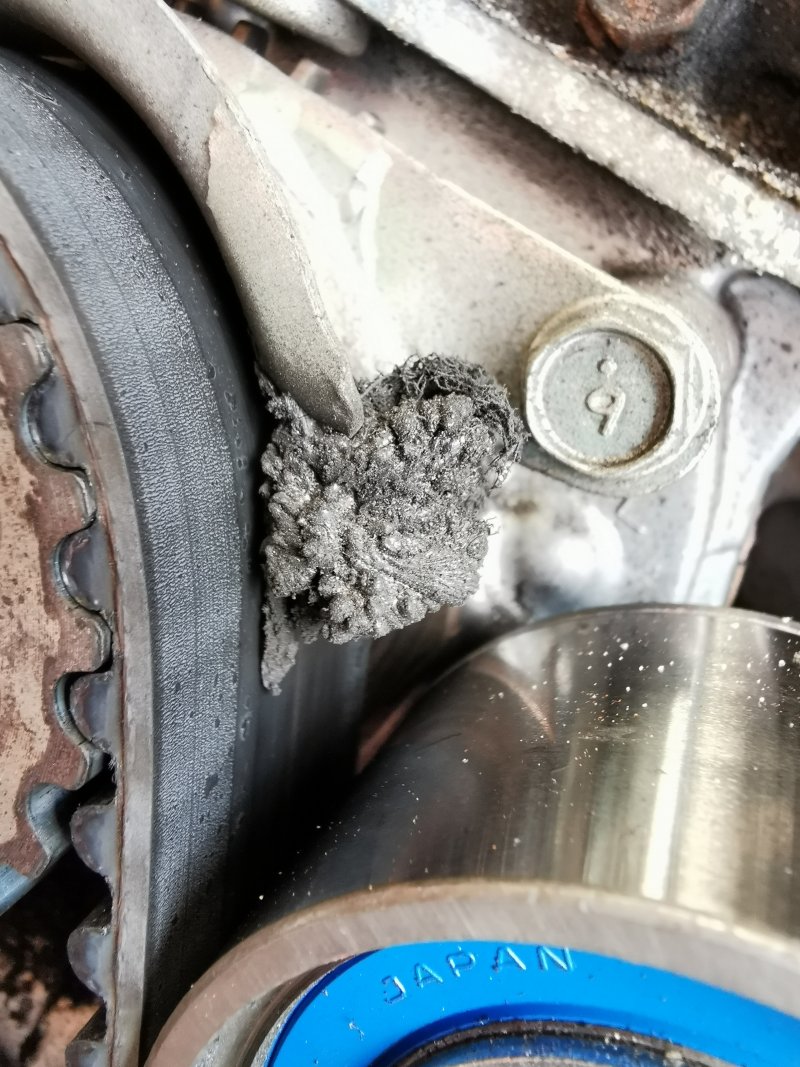

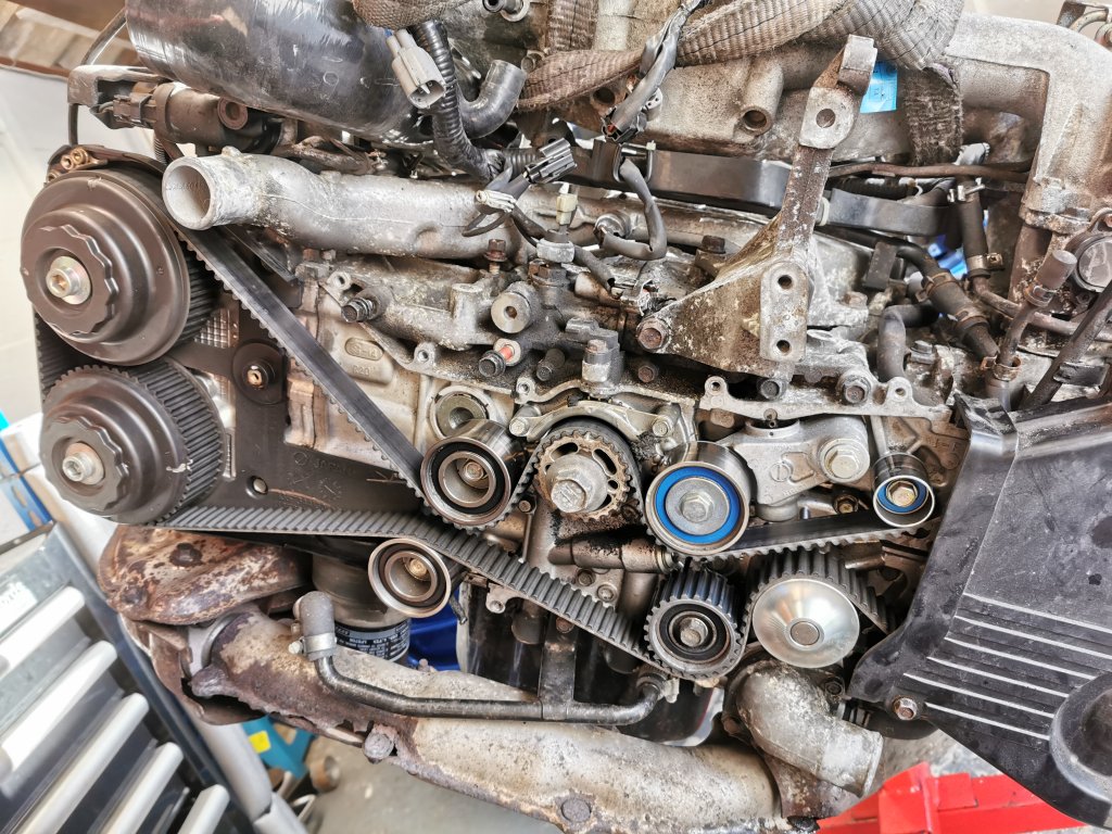

So.... looking at the old engine that i'd just pulled.
I'd been lucky. The old cam belt had been rubbing the guide for years by the look of things.
General condition. OEM exhaust heatshields barely hanging on.
Yuk. Rocker cover gasket failure on both sides.

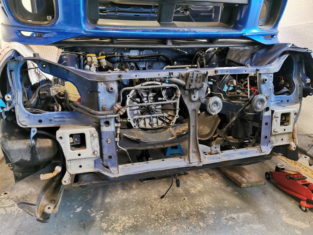

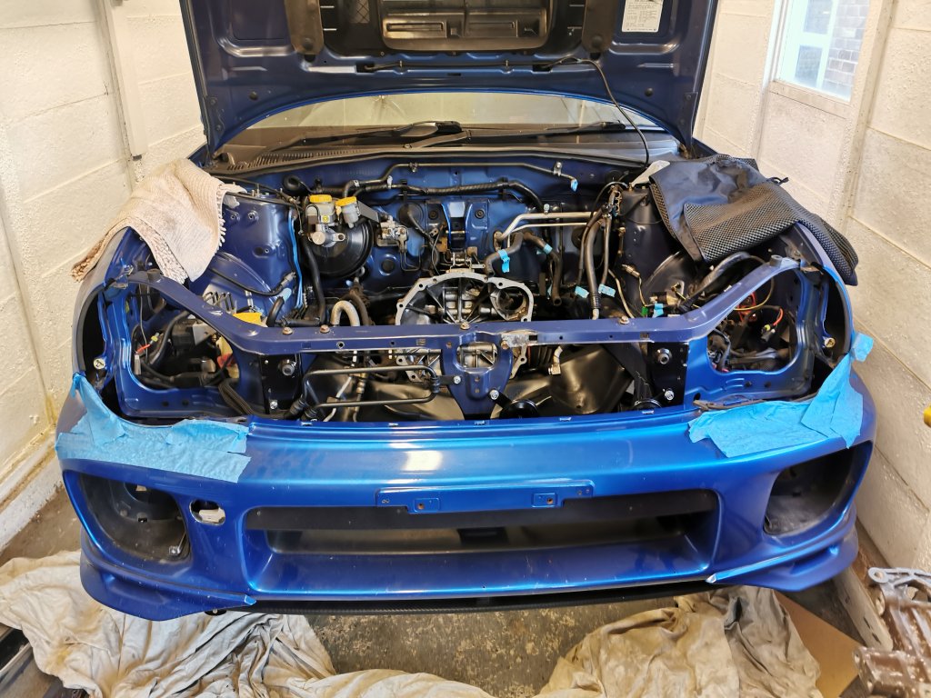

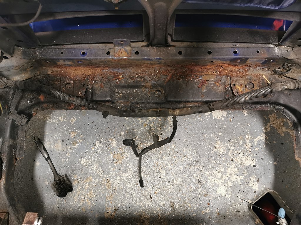

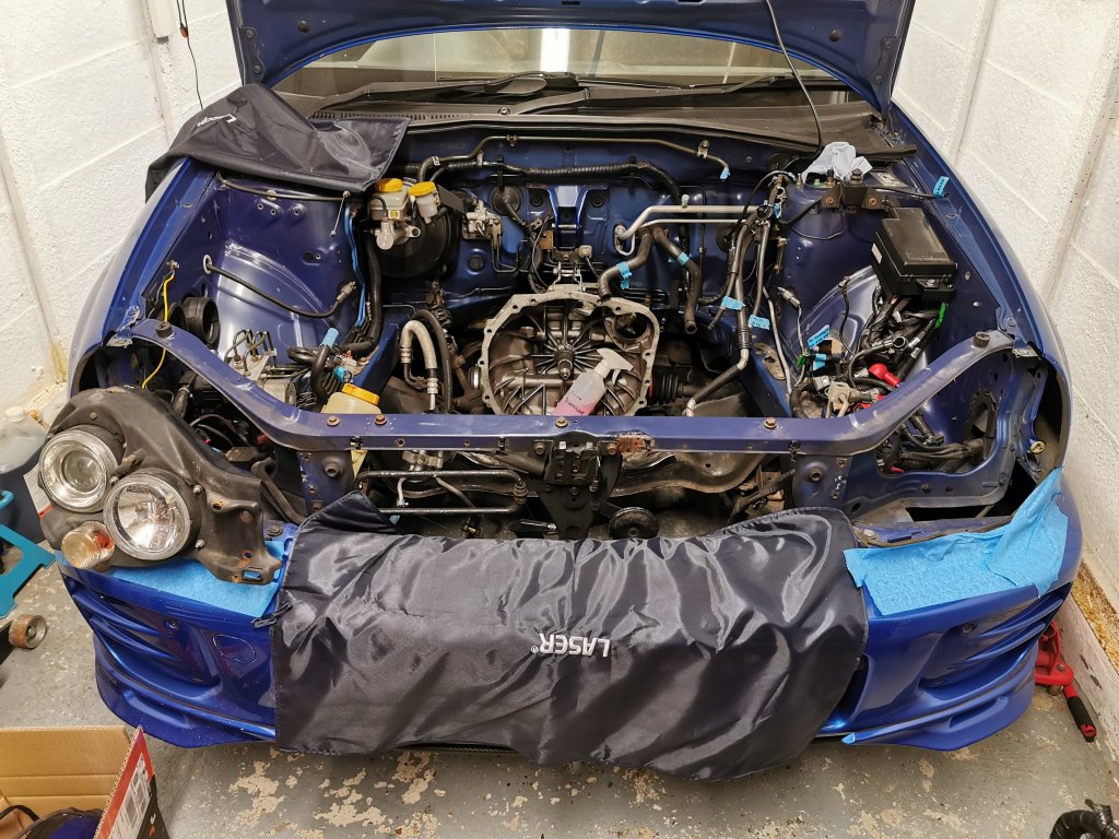

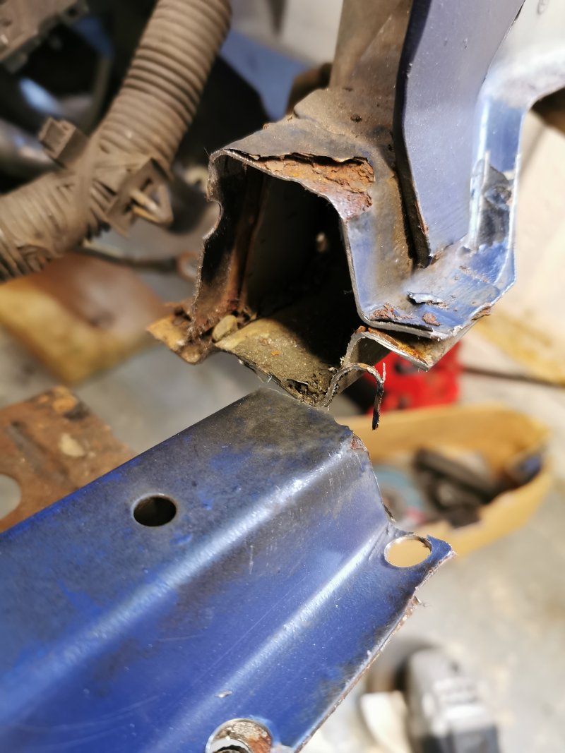

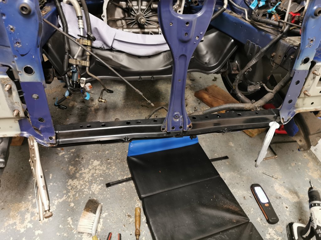

Now it was onto the cleanup phase of the empty bay. Everything was just grim. I started removing every bracket, fixing, anything that could be unbolted and cleaned it up. Metal brackets with surface rust were sanded down, rust treated and painted with metal paint.
Ended up draining the power steering fluid and removed all of the hoses/bottle for that to clean out, then separated the pump from the bracket to be cleaned and painted.

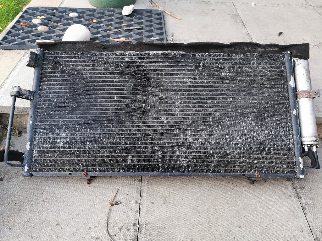

Then decided it was necessary to get the AC degassed (not to atmosphere) and remove the condenser. At the front of the car, it has a hard life. It looked grim, and the metal fins were all flakey. Another part to replace....

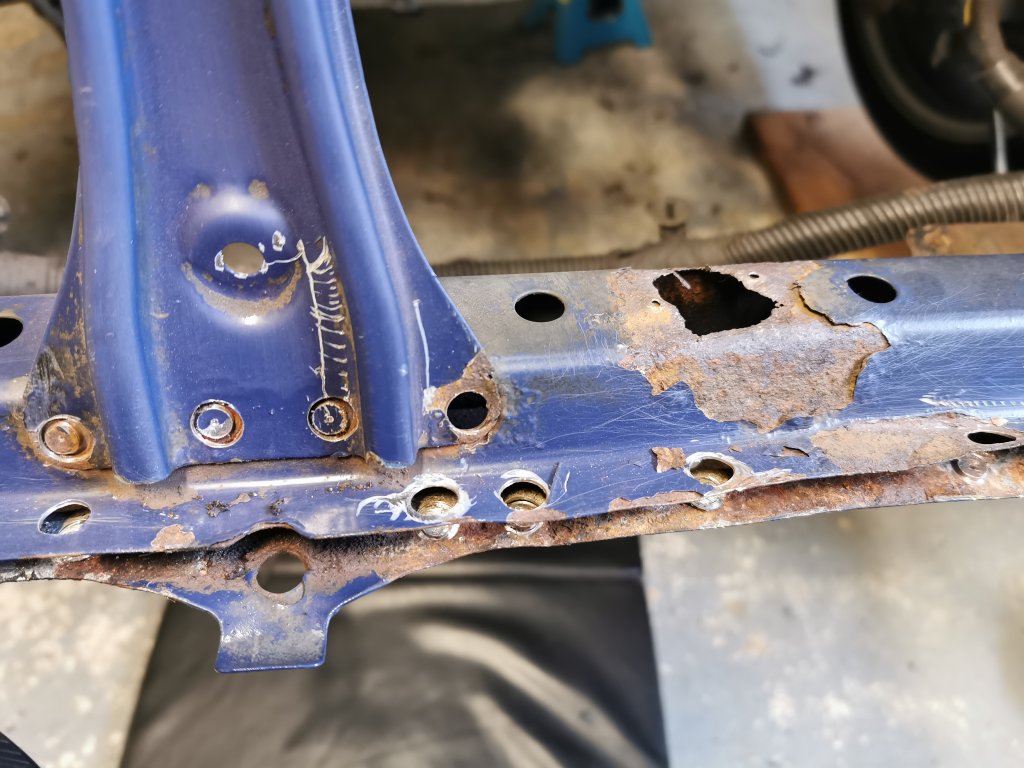

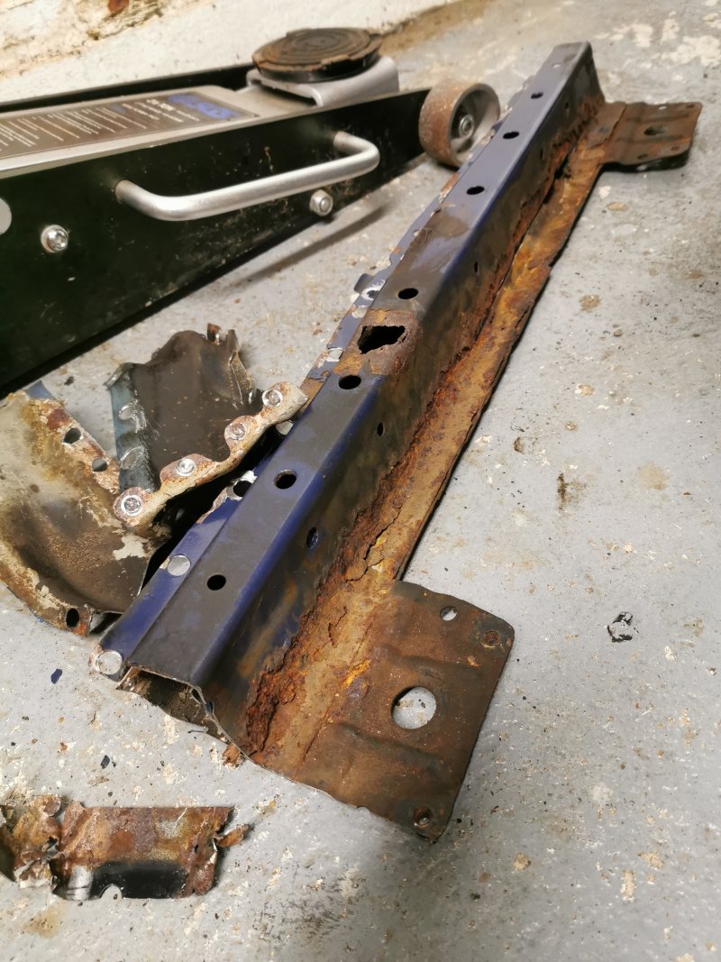

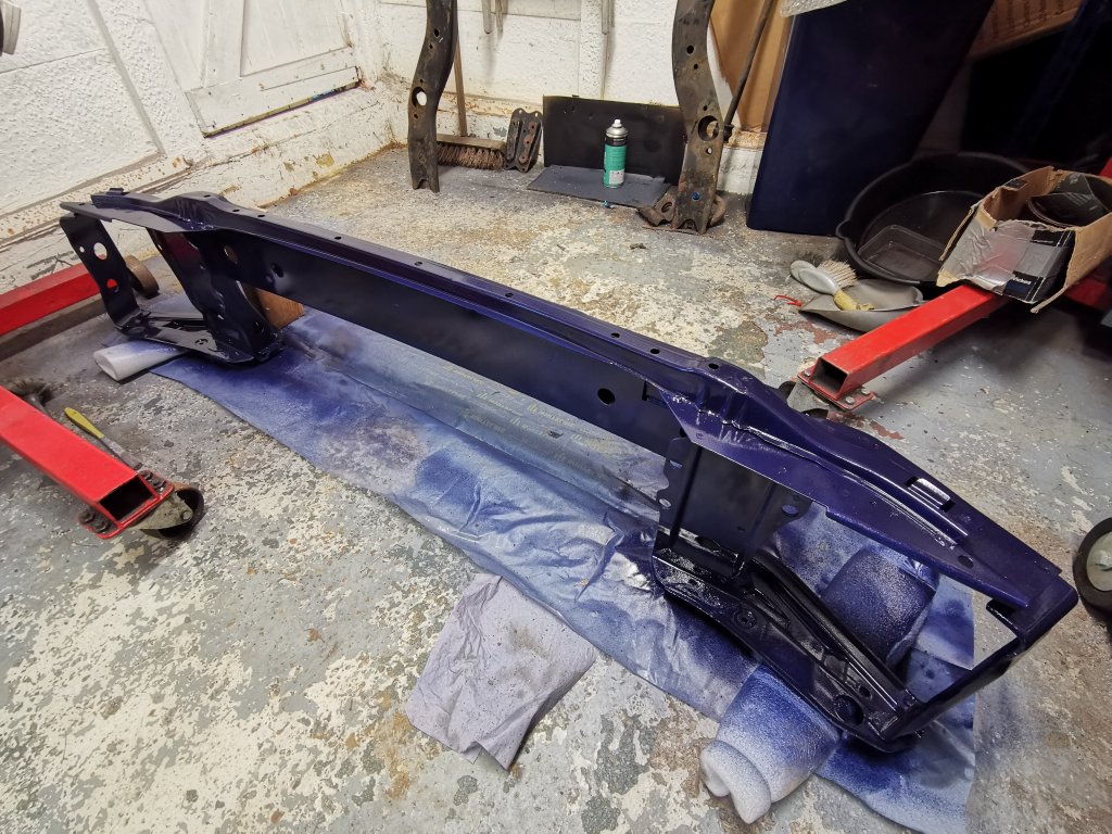

And this is where the fun really started. Underneath the AC condenser, hidden from view, and behind part of the wiring loom, I found this.
I've since done research online and found its a common newage problem - some people with blobs and hawks are in much worse condition than mine. After all, its been garaged most of its life. You know its a common problem when Subaru release a genuine repair panel!
https://www.importcarparts.co.uk/parts-info?id=11459

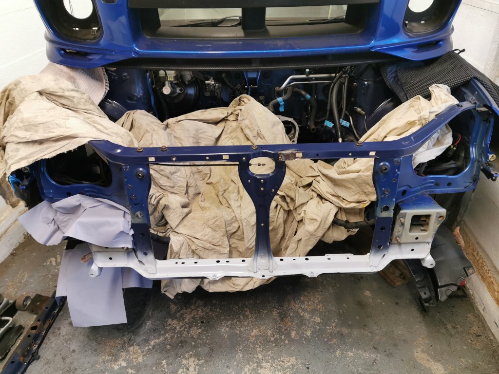

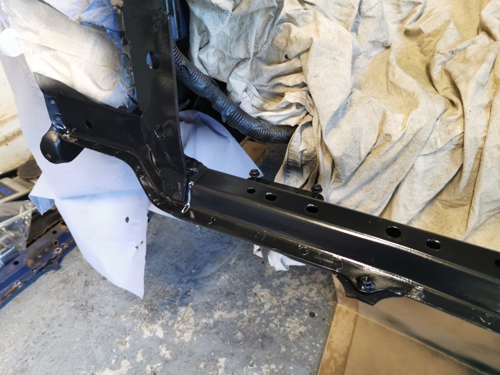

The problem with this.... its weld in, not bolt in. So i've got to strip the front end down further and see what I find, and organise a mobile welder to come and help. And this is where I am at this point.
Bumper will hopefully be coming off this weekend and hopefully the rust is limited to the lower radiator support bar. But either way, it looks like the U-cradle will be coming off too for a checkover and cleanup. Might get it power coated before re-fitting.
Car as it sits today:
And replacement engine sitting ready to drop in. Power steering pump and AC compressor cleaned up and fitted.
Fun times! The receipts from ICP are certainly stacking up

I was worried I was going to find the same rust on mine when I pulled the radiator out but it was actually solid with minimal surface rust, the same panel is available for the classic which made me think it would be bad.
Not scare-mongering but the majority of the rust on mine was hidden by the AC condenser, even once the radiator was removed. Only because apparent when the condenser was out and the wiring loom pulled back out of the way.
Hopefully yours is fine, but I guess they get bad as nobody usually moves the condenser out the way due to the hassles of degassing the system.

Good right up, and looks like your deep in it now, if you want advise on doing the repair panel let me know, ive replaced it properly using the oem lower panel.
Most uk newages will have gone or starting to go there, its a water trap, all the spray when driving in any wet weather goes in there and the grit etc rubs against the loom causing it just to rot out. The good thing is you can replace it like for like, its no way a structural point its simply there to hold the rads.
Good shout with the modine seal not something id seen before so very well noted.
EDITED: That camblet tho! You have been lucky ducky on that one...

So... 6 weeks later and today was the first decent chance I've had to get out in the garage and crack on. Since my last post in this thread, I've basically had to work stupidly long hours (first couple of weeks were 100+ hours) due to an IT related disaster. Been a complete nightmare and I nearly quit several times but stuck it out in the end - mainly because they would force me to work my 3 months notice even if i left! The joys of working in IT Infrastructure.....
Anyway, enough of that. Scoob progress below
Bumper off to start the front end tear down.
Not much rust hiding elsewhere thankfully, just filthy dirty.
Front crash bar removed.
Need to work out the best option to replace this - its where the external air temp sensor goes and is rusted to feck. Its spot welded to the lower radiator support panel which is being replaced, but the new panel didn't come with one. Might be able to fabricate something but I've never really worked with sheet metal before. Either that or just cable tie the temp sensor up somewhere afterwards!
Front U frame removed, surprised how easily all the bolts came off. I was dreading one of them snapping but all good Not sure whether to get this blasted and power coated or just try and find a replacement. It'll clean up alright but there is some internal rust that the blaster won't get too. Nothing bad but still....
Front subframe cleaned, few rust spots treated and then painted to keep the moisture out.
And then the fun started... drilling out all of the spot welds to remove the old rusty section!
Hmmmm... never done this before
New section held in place with a couple of clamps and ready for welding.
And a photo of the junk that came out!
Hopefully once all welded up and painted, I can start putting things back together. What started as just an engine swap has morphed into a bigger project than expected...

New Year update! It's been cold and wet and my enthusiasm for getting out in the garage isn't really there at the moment. But on the plus side, some progress has been made here and there... the engine came out 3 months ago and I'd hoped the car would be on the road before Christmas. Well, that was the plan until I found the rust. Anyway, its all sorted now
New section welded in (thanks CJ!) and then etch primered.
And then a coat of black.
Followed by a coat of stonechip and then two coats of heavy duty lacquer.
Both front chassis legs, the new welded in section, and the front crash beam (once painted) were then all treated to a couple of internal coats of cavity wax as well. I don't want this rusting again!
Wiring loom run back in place with new clips, with the new radiator supports/rubbers. Finally, things are going back on the car rather than coming off!
Front crash bar was cleaned down, rust spots treated with converter, then etch primered, painted and then two coats of heavy duty lacquer. The paint was ordered online and is supposedly Subaru 'True Blue' - colour code CS31, which is what the WR blue cars have as their internal engine bay colour. At least according the the info I could find online.
Either way, the match is nowhere near. It's not really as purple as it looks in the below picture, but its still not close.
And refitted to the car - see how much darker the paint is.
Oh well, its not actually visible once all back together so it's not a problem. At least it'll keep it corrosion free for the next decade or so!
Other things done.... power steering cooler has been stripped, primered and painted black as it was all chipped, now back on the car. Horns have had the same treatment. Pretty much all fixings are being replaced as I go with shiny new ones.
And bumper refitted yesterday. Well, hung on the car anyway. Have all the plastics clips ordered new from ICP so they'll be getting done and arch liners clipped back up tomorrow hopefully.

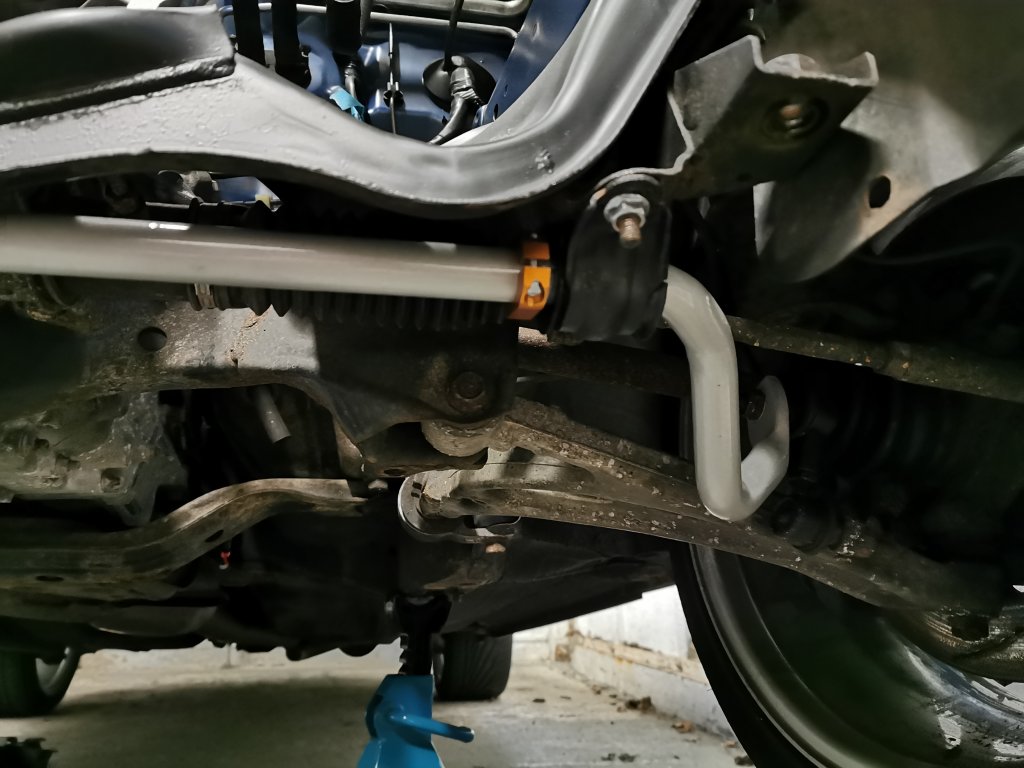

Only other stuff done lately.... rusty old front ARB (oem Subaru) is in the bin and new whiteline upgrade fitted. Droplinks were already whiteline adjustables and have just been cleaned up.
Getting there, bit by bit! The struggle now is going to be remembering where everything goes - and where I've put all the bits while they're off the car!
