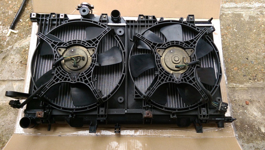

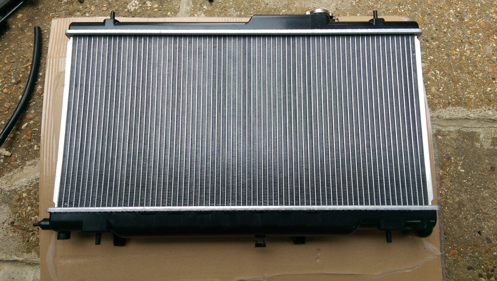

Bit of an update... done a few bits over the last couple of days.

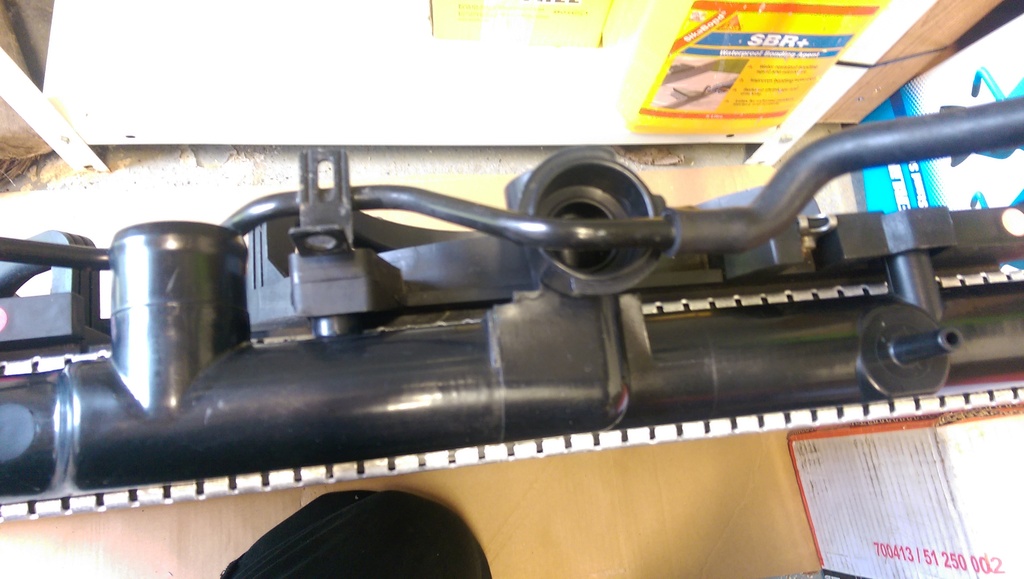

New radiator arrived from Alyn. Shiny
And fitted up with fans after giving them a clean.
Went with the blob one with the rad cap as it was available quickly. I thought it was just a hose tweak (Alyn threw in a t-piece and length of hose to do the job) but now realised the metal overflow pipe that runs along the top of the radiator fouls the cap
Could bend it but it seems a bit fragile and don't want to create a tiny crack/weakness so need a blob equivalent. Anyone got one spare kicking around? Otherwise will pop into JPP before the weekend.

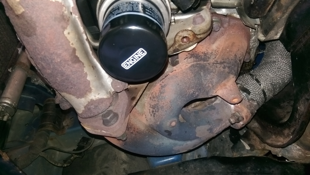

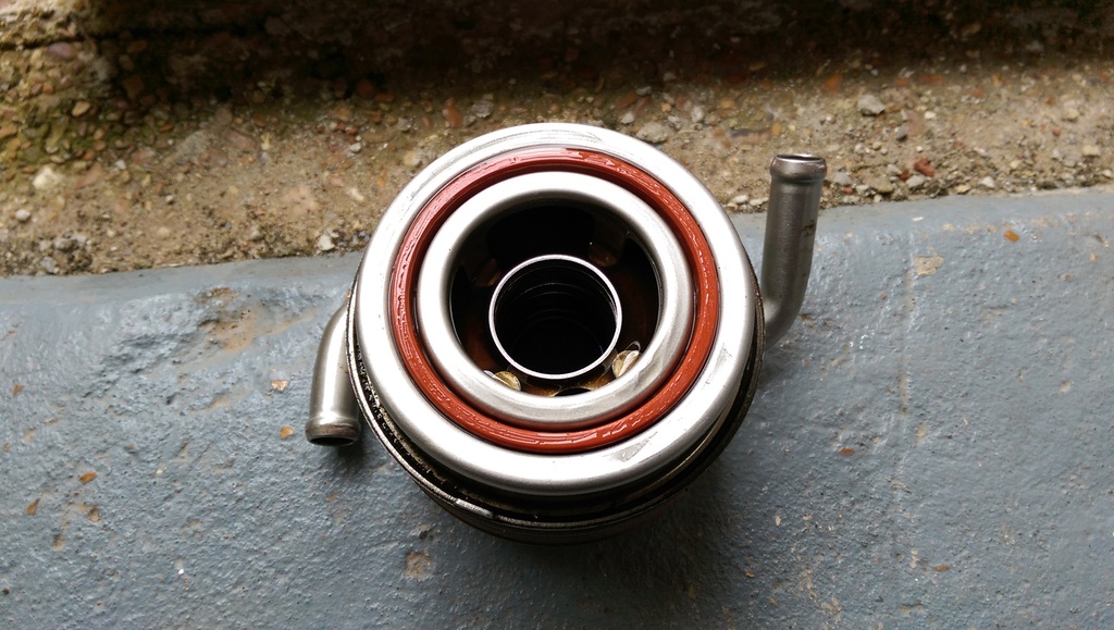

So... on with the oil leak. Always suspected this was caused by a bad seal between modine and engine block, so removed the modine hard pipe first. Old vs new:
And once out the way, modine removed and O ring replaced
Looks clean enough above so hopefully it was just a failed O ring and job done. Now all re-fitted with a new oil filter. Topped up oil (only lost about half a litre removing filter/modine) and its only about 500 miles old so didn't do a full change.

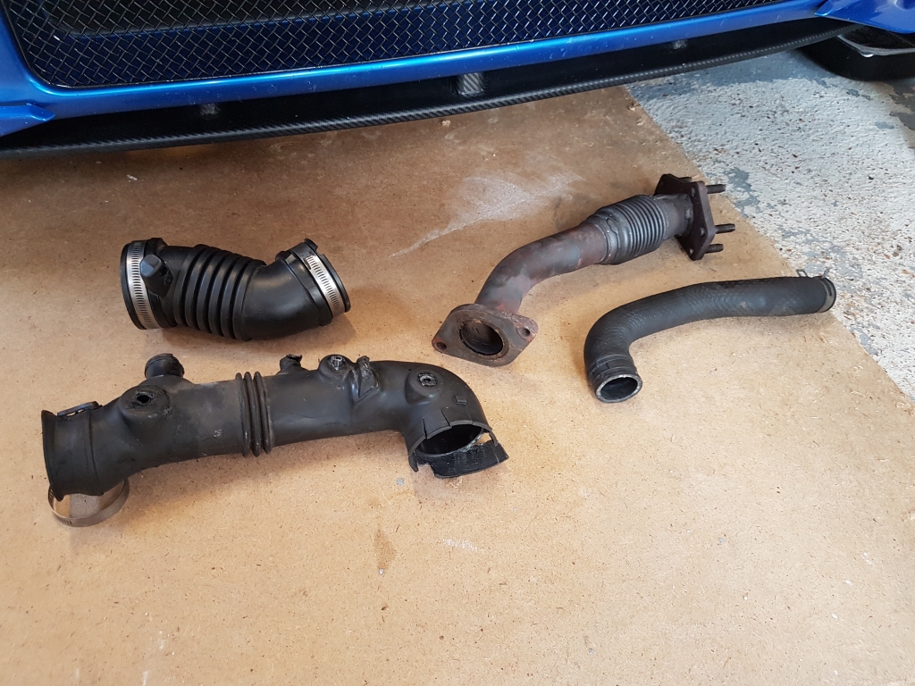

Also noticed that the heatwrap on my uppipe had nearly all gone, was obviously not very good stuff as it had all gone brittle and split - sections (basically anything not under a steel tie) had disappeared! It'd been on the car for 8 or 9 years though. Had some decent wrap spare so with the car in the air, looked at the options of wrapping it in situe. What a pig of a job, but its done. Combination of access from underneath by removing nearest header heatshield, and from behind the subframe (arm inserted through gap above the driveshaft), whilst the old man helped from above (airbox removed). Still preferable to taking turbo out to remove uppipe though, as that's another fairly big job in itself... you can see it freshly wrapped on right hand side (ignore the rusty oem headers!)
Hopefully get her back on the ground and running this weekend!

Thanks guys
Good effort in wrapping the up pipe while it was still fitted i need to re do my downpipe at some point .
Having done the uppipe and got fairly well acquainted with the underside of the car, I think the downpipe is easily wrappable whilst it is on the car - assuming there's the same clearance as on a newage.
Nice one Steve. At least it'll be tip top for Germany
That's the plan... just got to try and finish it off now and get coolant back in without airlocking it.
Are your Nankangs all good from last years trip?
Should be mate, they've been in the shed since last November though. Once the car is moving again they'll be going back on (no room to swap wheels in the garage).

I managed to bend the hard pipe on my blob radiator without any issues - try a hot air gun first though. I'm actually thinking it looks a little tatty so may just replace the whole pipe with silicone all the way along the rad.
  #261
Old 20-04-2016, 12:55 PM
I did think about running hose all the way, but it looks neater as a rigid pipe and I guess Subaru went that way to prevent issues with flex and slack getting caught in the rad fans.
Getting the blob pipe will be the tidiest, as I think it has the T piece all as one part of the pipe.

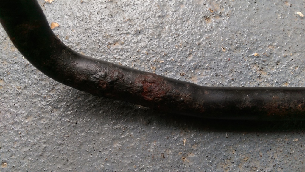

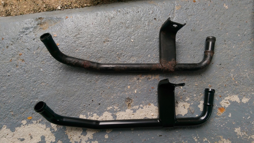

Coolant overflow pipe sourced from JPP for £15 Not bad considering Subaru wanted £57.90

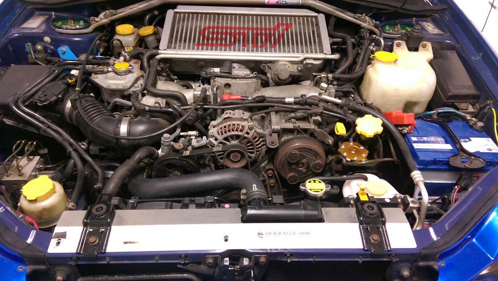

Another update, did a couple of hours in the garage this evening.
Replacement hoses and clips arrived from Alyn today for the modine hard pipe, as the old hoses were pretty crusty. They're right next to the headers so must get hot all the time, which probably helped them perish a bit. Anyway, replacement pipe all fitted.
Also got some decent jubilee clips round the top/bottom of the wrapped uppipe which should help to hold it in place, and the header heatshield, airbox assembly refitted.
Finally got the radiator fitted, new metal overflow pipe from JPP works a treat as you can see:
All hoses put back in and tightened up, fans plugged in, overflow bottle cleaned and back in and pretty much there.
So, at the weekend i'll get it off the axle stands and put new coolant in. Done some reading as it sounds easy to airlock them but a lot of people recommend filling from the bottom up via the turbo hose off the back of the header tank. Hopefully it'll be nice and easy

She runs
Was a little concerned I'd airlocked it at first as after 10 minutes running (at idle) the water was roughly up to temp, rad top hose was hot and pressurised but bottom hose was cold. Wasn't sure as I had heat in the car without any problems. Left it to cool down and guess it was just that the thermostat hadn't opened (fans didn't kick in). Tried burping both top and bottom hoses and no noticeable air came out so wonder if having the heater fans on full in the car was taking enough heat out to stop it getting hot enough.
Checked it when cold and all levels looked good, so took it for a run last night. This time got up to temperature nicely, fans kicked in and everything working. Gave it quite a bit of stick (including a few big stops to clean up the brakes where its sat for a while) and temperature stayed where it should on the gauge so no overheating....all good I think
Oh, and no more oil drips so definitely looks like the modine seal was the cause Now she just needs a swap to the other wheels/tyres and a damn good clean/polish and she should be ready for Germany.

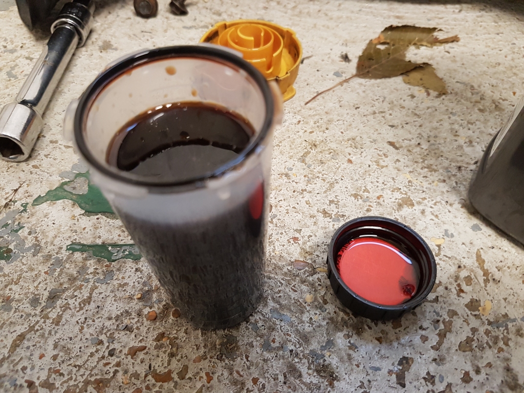

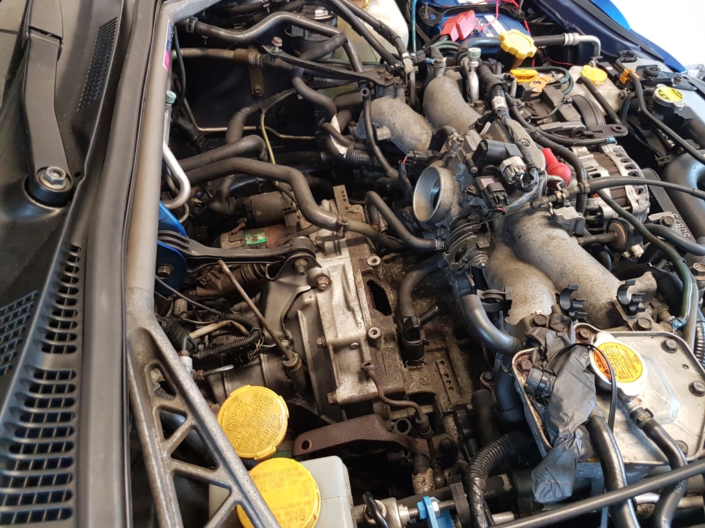

So... as many of you know, the scoob wasn't faultless in Germany. On the plus side, no problems with the radiator and the oil leak anymore
But on the downside, it looks like head gaskets are failing. Car overheated on 3rd lap of the weekend, pushed some coolant out the overflow bottle and got bubbing in the bottle too (even for 5 mins after engine switched off). Coolant level has been fluctuating too and there's no leaks so its going somewhere... so despite driving absolutely fine on the way home, there's obviously an issue when on track.
So, what to do. Considered breaking and moving onto something else but i'd need to drop £10k+ to find a nice example 2.0 widetrack or better. There's £4k-5k of parts on mine if I did break (yes, I went through it painstakingly...) but i'd probably end up keeping some of those parts like wheels, Lateral sump, ksport brake kit etc so I'd end up with less cash than that.
Think the easiest/best solution is to try and get a low miles STI8 long engine from a reputable breaker and drop it in and then map. Transplant the sump and new hoses of my current engine beforehand. I'm reliably informed I can just run with the AVCS heads unplugged....

Well.... this hasn't been updated in over a year!
Existing engine is still going, its done another Ring trip but no major head gasket/coolant issues so I guess the problem isn't getting any worse.
Did have some issues in Germany though, although not strictly engine related this time! Actuator on the turbo seized up which left me with the wastegate stuck open and no boost. Few repairs in Jackie's car park and the car ran boost again (got 2 more laps out of it!) and got home safely.
Actuator since replaced, still had a fluctuating boost issue but that had occasionally occurred before the ring trip too. Between 3-4k rpm it would just feel like the boost was dropping off before re-spooling and going again. Tried another boost solenoid but problem still there. Also had a problem with a flashing engine light on long 4th/5th gear pulls, which research suggested might be the neutral position switch on the gearbox.
Anyway, onto yesterday Huge thanks to Rob for spending the day at mine yesterday helping out, the scoob got new plugs, new oil (twice ) and filter, new neutral position switch fitted, handbrake slack adjusted etc.
Oil was a mare, some of you have heard about Millers oil and jelly like lumps etc, well I had a bottle of it. See here...
http://www.southeastscoobies.co.uk/v...ad.php?t=21462
Wasn't happy with lumps going in the engine as it could block oil ways/filter etc, so we dropped it back out and put a newer bottle of Millers 10W-60 NT+ stuff in there (I already had it, hence didn't go with a different brand). What a waste of £50 of oil, but what can you do. Miller's say there isn't a problem apparently.... thankfully the newer NT+ stuff didn't have the same problem.
Still had boost fluctations so did a MAF swap (from Rob's scoob) and it was a lot better. So going to invest in a new genuine MAF, as mine's done 100k now. Will see how things go but I expect after that it will a case of getting a certain friendly mapper to hook up a laptop and see what's going on.
I'll get there soon!!

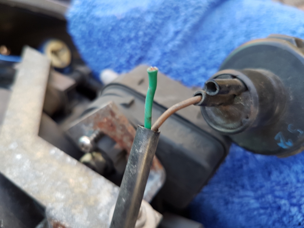

Well.... so here we are another two months down the line. And it looks like the scoob is sorted
Huge thanks to Rob for giving up two weekends and assisting with much spannering, tea drinking and humour (of the shaft, nut and hole variety, mainly ). Plus, donating various spare bits & bobs and supplying plenty of new jubilees. But yeah, thanks mate, I'd never have got it sorted on my own
So... it looks like the turbo was the problem all along. Bought a second hand TD04 off a member on here in Hastings and Scott dropped it over as he was passing. As soon as we got my old TD04 off, we knew it wasn't right. There was a load of shaft movement, and you could see a paler area on the intake housing where the compressor wheel has been scrubbing. Add to that, it felt notchy when spinning it and a whole load heavier to turn by hand than the replacement and we thought we'd found the problem.
Twin turbo conversion?
Uppipe was removed as it needed re-wrapping and to refresh old gaskets. In the process of removing the turbo, we also found that the OEM inlet hose was split in the rubber section. It looked like the jubilee had munched it up but it was only good for scrap. So we began destroying that to remove it, as taking the intake manifold off wasn't really on our wish list! Even with all the ports cut off, what an absolute pig of a job. There really is sod all space to manoeuvre it out of there...
The list of bits coming off the car grows....

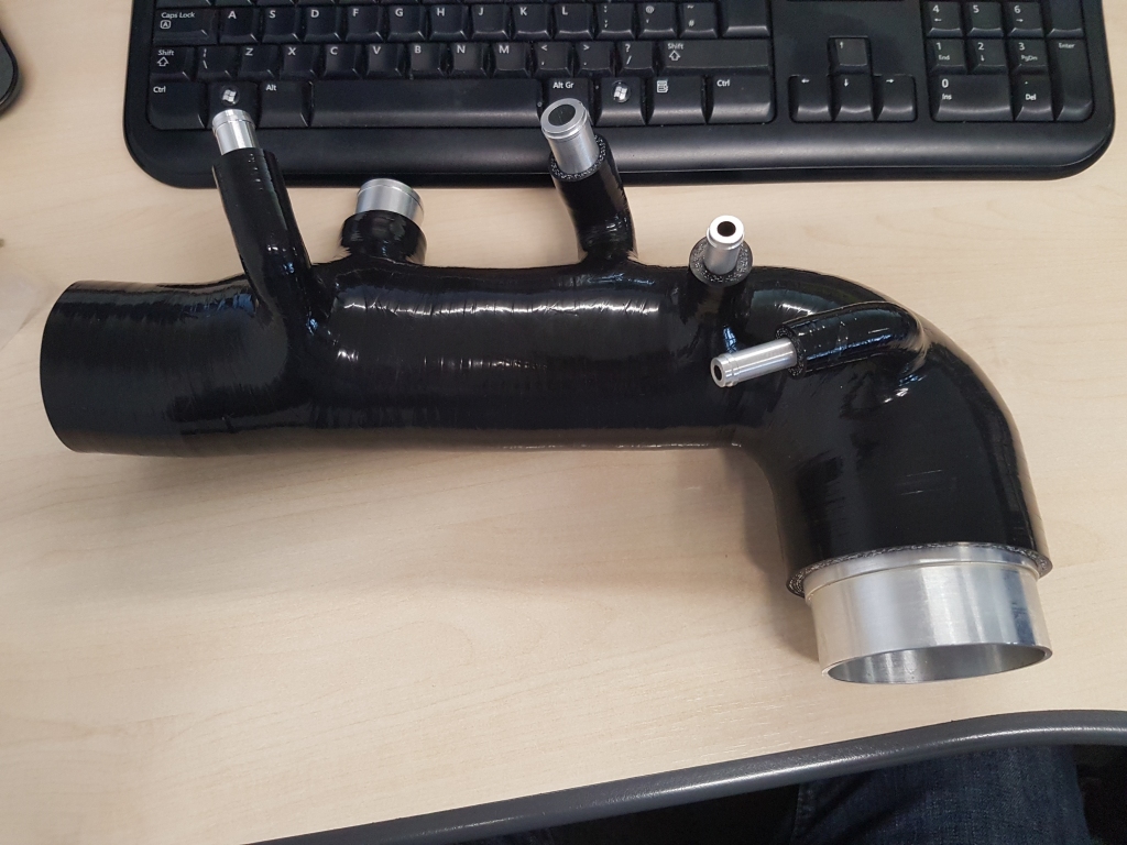

New turbo inlet, found one that was still thick ply with reinforcing wire (and not cheap ebay tat) whilst still having removable aluminium ports (to aid installation) and not costing £250+ like a Samco or Perrin. There is no way in hell that we'd have got it installed with moving the manifold without removing the aluminium bits...
And then put it all back together again. Mostly in the right order!
Took it for a test drive and it was clear that the fluctuating boost was gone, it pulled smooth all the way through. Thank fook for that. But in a last ditch attempt to annoy us, the car gave us two new gremlins... air had got in the power steering and wouldn't bleed out making the pump sound like a bag of bolts, and I randomly got a double-speed left indicator flash suggesting a bulb was out. No indicator on front morette, so whipped that out. Bulb fine... but:
Of all the random crap... so out with the soldering and a new spade connector. Job done.
