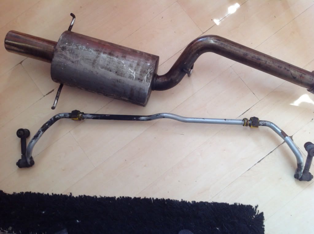

Also picked up a rear arb and droplinks - mechanic seemed to think it was an uprated one which was taken off when car was mostly returned to standard wr1 spec prior to sale - any way to identify the arb as scooby or aftermarket ?

Im hopeful the rear arb is whiteline item which will be great if so - it had a sticker on with B------ markings but it was covered in grease or something and when i wiped the grease off the sticker the letters went with the grease !
Studying the net a little it looks like it could be a whiteline item as its silver or are all rear arbs silver ? Ir std scooby ones would be silver ?

Posts: 466
This is the arb and the rear section of exhaust ,, anyone know if its a whiteline arb ?
Old 29-05-2014, 07:33 PM
Looks like whiteline to me
Oh sweet ! Thatll be a result then ! Thanks for letting me know
Old 29-05-2014, 08:37 PM
id say whiteline as it has the yellow bushes

Posts: 466
Yup they are yellow indeed ! Sounds like good news then ,, should i start looking for some uprated drop links to go on with it or just use whats there already on the car ? - no knocks etc atm so presuming my droplinks are ok atm although past experience on other cars tells me they often dont undo very well without a struggle
